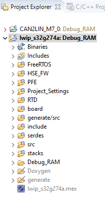

viswa_kondapall
Hi Manyank,
After going through the code its is implemented only for Ping and this is outdated code. But we want to use full TCP/IP stack features and we like to use PFE-Demo with latest RTD and RTOS. how to do for this ??
I am doing a trail with S32DS 3.5 with 1.3 TCP/IP stack and latest RTD and RTOS. Project has very few folders. Do we need to add HSE/PFE/RTD files like in PFE_demo code. could you please guide me here. below example code :
PFE_DEMO code folders:
Viswanath K

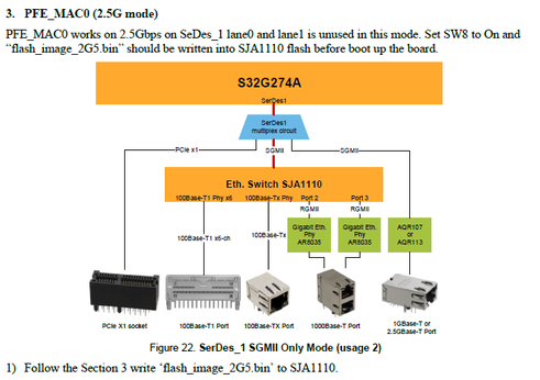

viswa_kondapall
Hi mayank,
We followed the document PFE quick start and other document given in the pfe_demo. Ping is not wokring.
My doubt is do we need to flash SJA1110 bin files in SJA1110 switch ?? for M7 firmware procedure ???
Viswanath K

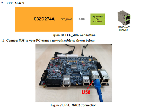

Hi @viswa_kondapall,
It depends on which port you are using for the ping.
PFE_MAC0 and PFE_MAC1 is connected through SJA1110 switch and PFE_MAC2 is connected directly.
If you are using PFE_MAC2 then you don't need to flash SJA1110 switch but you can try to flash the switch and then check.
Also, there can be possibilities in error. Are you using SD Card for Flashing lwip app? or using S32 Probe?
Also, on a serial terminal error logs comes out from the bootloader. can you share the same error logs here?

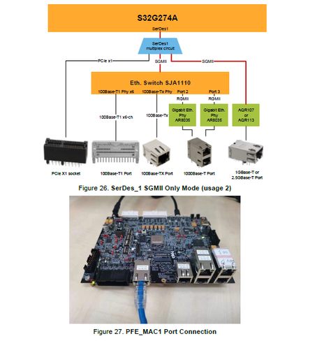

viswa_kondapall
Hi Mayank,
Small doubt on PFE_MAC0/1/2.
We are configuring/connecting PFE_MAC0 to 2.Gbps/ PFE_MAC1 to 1Gbps and PFE_MAC2 to Gbps.
I think PFE_MAC2 is direct connection. but How PFE_MAC0/1 are connected ?
Is it through Serdes and SJA110 switch then which are need to configure. We dont have SJA development package to change the confgiration 1-2.5Gbps and 2-1Gbps.
Serdes need to bin file to load ?? or SJA1110 PFE_MAC0 - 2.5Gbps bin how to get. I mean how to get the bin file or files for the 2 PFE_MAC0/1 is it 2 different files or both configuration in 1 file. ??

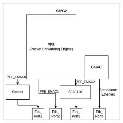

MayanksPatel
PFE_EMAC0 is connected to the Serdes and Serdes is having two ports Serdes0 and Serdes1.
Serdes0 is connected to the PCIE interface and Serdes1 is connected to Eth Phy.
PFE_EMAC1 is directly connected with the Eth Phy and GMAC RGMII port is shared with it.
PFE_EMAC2 is connected with the SJA1110 Switch. Please refer to the attached diagram which shows high-level Ethernet architecture.
By default, SJA1110 is configured at speed 1G FW. If you want to use 2G then need to change the firmware of SJA1110. for that, you need to get information from the vendor.
The Serdes configuration method is available in the BSP User Manual. Please refer to this and also, serdes sample application available in the PFE Packages.
NOTE: Attached ethernet architecture image explains very high-level detail.
Hope this helps you.

Ethernet Arch not opening -- its very small size may be not fully uploaded.
Viswanath K

Please correct me if i am wrong.
Ethernet enablement document is saying :
1. PFE_MAC2 is directly connected --
PFE_MAC0:
My understanding is for PFE_MAC0 needs - serdes and switch for the SGMII mode for 2.Gbps.
PFE_MAC1:
PFE_MAC1(Connect to AQR113C or AQR107)
SerDes_1 works on SGMII only mode. PFE_MAC1 works on lane1. Set SW8 to On in this mode.
1) Follow the Section 3 load ‘flash_image_1G.bin’ to SJA1110.
2) Connect U86 to your PC using a network cable as shown in Figure 27
Please correct me if i am wrong. Which is one is correct. ??

MayanksPatel
Sorry for the same. The mistake made by me while drawing the diagram as I was referring to the wrong document. The document you are referring is right.
I will get back to you with an answer to your question.
Thank you for your patience.
Mayank s Patel
36,148件の閲覧回数
viswa_kondapall
Thank for the Ethernet PIC. Is it mentioned in any document ?? or drawn to help us ?
