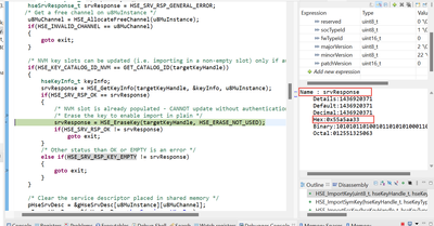

hi,Black8Mamba
Sorry for the late reply.
I have tested HSE_DEMOAPP_S32G2XX_0_1_0_14 demo. The picture is my experimental phenomenon, srvResponse = HSE_SRV_RSP_OK. To perform this demo test, you can refer to the HSE_DEMOAPP_S32G2XX_0_1_0_14_ReadMe.pdf document. Also, make sure that you can view the loaded HSE FW version through gHseFwVersion.
Joey_z_0-1731643170795.pngJoey_z_0-1731643170795.pngJoey_z_1-1731643178657.pngJoey_z_1-1731643178657.png
Hope it can help you!
