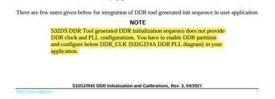

arun_belamge
Hi Joey.
In the document AN12848 I can see the following NOTE.
Can you tell me how to enable DDR partition and set the DDR_CLK?
Thank you.
Arun

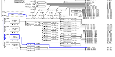

7,069 Views
Joey_z
hi,arun_belamge
Thank you for your reply.
Please try to set the DDR clock/partition in the below picture showing.
Hope this can help you.
Joey
7,065 Views

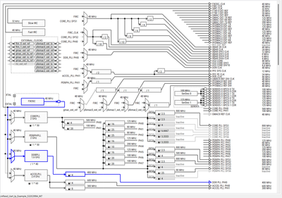

arun_belamge
Hello Joey.
I have done the same config using the Clock Tool
But i am not using any MCAL, the app is baremetal, and ddr_init() in app doesn't work even after the ddr clock enabled.
Thank you.
Arun
7,008 Views
Joey_z
hi,arun_belamge
I will help you to check this question.
