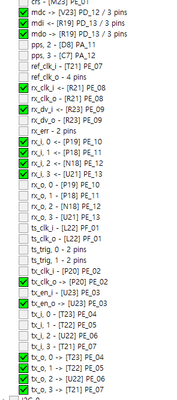

1) Pin : enable GMAC pins based on RGMII

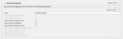

3. Eth_43_GMAC configuration : uncheck 'MAC_CONFIG_LOOPBACK'

11,319 Views
Mursal
you nee to configure Pins as per datasheet and Schematic. the direction of TX pins(including EN,CLk) should be output.
unckeck the Loopback mode
