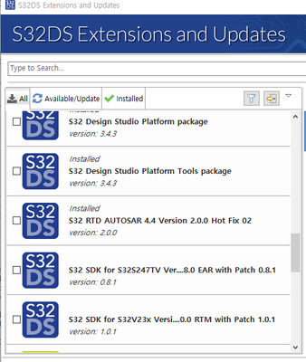

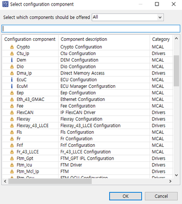

Installed :
S32 RTD AUTOSAR 4.4 Version 2.0.0 Hot Fix 02
But there is no Eth_43_PFE component in my component list:
please let me know how to use Eth_43_PFE componet on M7 core

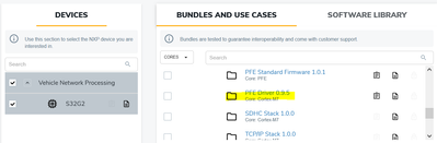

6,709件の閲覧回数
bpe
PFE driver for M7 core is a separate package. Use Automotive Software Package Manager  to download it:
Follow the documentation enclosed within the package on how to use it with S32DS

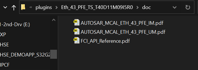

bpe
I think there is no document to follow...
The driver is packed with about 400 pages of documentation in three PDF files under eclipse\plugins\Eth_43_PFE_TS_T40D11M09I5R0\doc\:
1) if it is the right way to refer to this document
if not what document should I refer?
Plugins installation instructions can be found in Section 3.3 of the driver Integration Manual (AUTOSAR_MCAL_ETH_43_PFE_IM.pdf). The Release Notes generally describe the same steps. The both are valid.

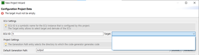

skseofh
And I downloaded EB tresos studio.
But there is no target that I can use;;
Could you let me know how to create 'Target' (S32G274A)?

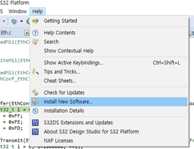

Here is what I've done.
 - install new software
- add 'PFE MCAL 0.9.6.zip'
But it said, "Could not find jar:file:/~~~~~~~~~~'
