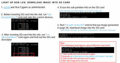

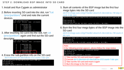

I am willing to booting the board via SD, According to the software startup guide document 《S32G-VNP-RDB2-SW-UG.pdf》, in the 'RUN Linux BSP On Cortex-A53 Cores' section, the BSP was written to the SD card,
But after power-on, there was no output on the UART.

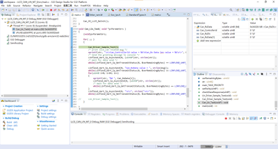

3. I have a "S32 Debug Probe" debugger. I can run some M7 programs in debug mode within the S32DS software. Currently, I have only run the routines according to the documentation and have not yet started the code development.

So far, neither the A5 nor the M7 can be automatically started.
After writing to the SD card and powering on, there was no reaction. When writing to the QSPI, it showed failure.
I could only connect the debugger and use the debug function in the S32DS software to run the M7 program , as shown in the picture.

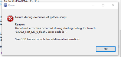

I followed the above method and used the debugger to flash the binary file.
I started the flash and clicked Debug. It showed an error, as shown in the picture.

Well, you will encounter the same issue when using the debugger to flash the QSPI?
Since you are able to load the elf to the SRAM, you may try loading the flash example code from RTD to test the QSPI on your board.
