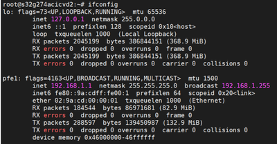

pfe1 config:
root@s32g274acicvd2:~# ifconfig
lo: flags=73<UP,LOOPBACK,RUNNING> mtu 65536
inet 127.0.0.1 netmask 255.0.0.0
inet6 ::1 prefixlen 128 scopeid 0x10<host>
loop txqueuelen 1000 (Local Loopback)
RX packets 557774 bytes 58349060 (55.6 MiB)
RX errors 0 dropped 0 overruns 0 frame 0
TX packets 557774 bytes 58349060 (55.6 MiB)
TX errors 0 dropped 0 overruns 0 carrier 0 collisions 0
pfe1: flags=4163<UP,BROADCAST,RUNNING,MULTICAST> mtu 1500
inet 192.168.1.1 netmask 255.255.255.0 broadcast 192.168.1.255
inet6 fe80::9a:cdff:fe00:1 prefixlen 64 scopeid 0x20<link>
ether 02:9a:cd:00:00:01 txqueuelen 1000 (Ethernet)
RX packets 54125 bytes 25997549 (24.7 MiB)
TX packets 77032 bytes 26437355 (25.2 MiB)
device memory 0x46000000-46ffffff
root@s32g274acicvd2:~# cat /etc/systemd/network/10-pfe1.network
[Match]
Name=pfe1
KernelCommandLine=!root=/dev/nfs
[Network]
DHCP=no
Address=192.168.1.1/24
[Route]
Gateway=192.168.1.2

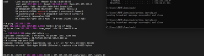

liubin123
pc window IP:192.168.1.166
testudp.py:
import socket
# 创建 UDP Socket
sock = socket.socket(socket.AF_INET, socket.SOCK_DGRAM)
# 设置 SO_BROADCAST 选项为 True,表示开启广播功能
sock.setsockopt(socket.SOL_SOCKET, socket.SO_BROADCAST, 1)
# 定义目标 IP 地址和端口号
#target_ip = '255.255.255.255' # 这里使用了默认的广播地址
port = 5432
# 构造要发送的数据
message = b"Hello, World!"
try:
# 发送广播消息
sock.sendto(message, (target_ip, port))
except Exception as e:
print("Error occurred while sending broadcast message:", str(e))
finally:
# 关闭 Socket
print("sending broadcast message successful and close")
sock.close()
python testudp.py
on s32g:
root@s32g274acicvd2:~# tcpdump udp port 5432
tcpdump: verbose output suppressed, use -v or -vv for full protocol decode
listening on pfe1, link-type EN10MB (Ethernet), capture size 262144 bytes
there is no any message achieved
but on other device(192.168.1.3):
RX packets 11427861 bytes 1336328242 (1.2 GiB)
TX packets 11427861 bytes 1336328242 (1.2 GiB)
RX packets 1022172 bytes 600321839 (572.5 MiB)
TX packets 2167118 bytes 1146522890 (1.0 GiB)
