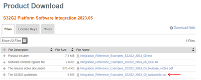

i am trying to customize a project specific bootloader from the S32G bootloader example that provided in "Integration_Reference_Examples". as i read the "UM_BOOTLOADER_Rev_2023.05", in chapter 3, "release layout" it seems imply that there is an already defined S32DS project for the bootloader, however, i can only find the Tesos workspace for the bootloader.
<package_installation_folder>/applications/realtime/S32DS/
workspaces/<workspace_name> - contains the S32 Design Studio workspace for a certain example (e.g.
Bootloader, Lighting etc.).
can anyone tell me how can i find the S32DS project/workspace for the bootloader example? or must i use Tesos to create the project?
thanks

We understand that you downloaded the *.exe file and installed it in your computer, is this correct?
If so, there is an *.updatesite file (aside from the *.exe) which is available under the same page:
If all requirements are fulfilled under S32DS, you should be able to add the *.updatesite file and install the plugin for the project to be available under S32DS.
Please, let us know.

Thanks, i have downloaded that and it works
