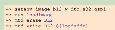

1. It is a little complicated for the setups of booting from QSPI under BSP43, so it is suggested preparing a bootable SD card in advance.
Once booting from SD, under u-boot, the following steps are shown for your reference.
chenyin_h_0-1747834551548.pngchenyin_h_0-1747834551548.pngchenyin_h_1-1747834579009.pngchenyin_h_1-1747834579009.png
The kernel, dtb, rootfs, etc. could be flashed similarly, for details, I suggest reading 4.2.5 of BSP43.0 UM.

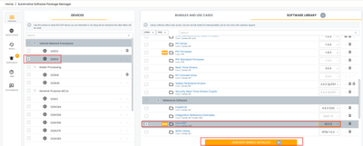

2. For accessing the BSP43.0 UM, firstly check if it existed in your NXP account, if not existed, I suggest applying it via the following link:
https://www.nxp.com/app-autopackagemgr/automotive-software-package-manager:AUTO-SW-PACKAGE-MANAGER
Click the button on the bottom right, and following the guide step by step, once it is approved, the BSP43.0 images and documents could be accessed from your account.

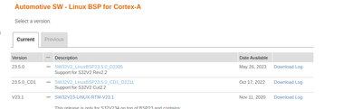

pcentauri92
Hi @chenyin_h ,
I am not tring to boot from SD card, I am trying to boot from NOR Flash.
Also, I am not able to find the UG for BSP43.0. When I go to the BSP for S32 Microcontrollers and Processors  page and access the Automotive SW for S32G3 – Linux BSP link, it leads to a download page but the version available there is BSP23.0 as shown below
Could you please guide me to the proper link for the BSP43.0 UG?
Thanks.
