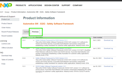

alejandro_e
Hello @Allen_Cheng,
Please check if you can see the version 2.0.1 in the Previous tab in FlexNet:
Here is the direct link: https://nxp.flexnetoperations.com/control/frse/product?child_plneID=830777&ver=ARC
Let me know if you encounter another problem.
