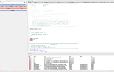

I can also see errors in the peripherals configuration which I assume are related:
Thanks in advance for the help.

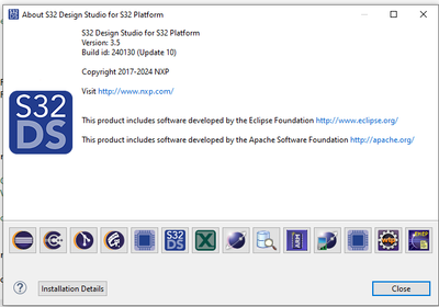

  1. Installed S32 Design Studio 3.5
    1. https://www.nxp.com/design/design-center/software/development-software/s32-design-studio-ide/s32-des...
  2. Installed S32 Real-Time Drivers Version 4.0.2
    1. https://nxp.flexnetoperations.com/control/frse/product?child_plneID=832137
      1. Download the updatesite.zip
      2. Add the updateside to S32 Design Studio and install from there.
      3. Also download, run, install, the .exe as it puts the files in the C:/NXP/ folder which is where the linker looks at by default.
  3. Installed S32G_LLCE_1.0.7
    1. https://nxp.flexnetoperations.com/control/frse/product?child_plneID=802837
    2. Also download, run, install, the .exe as it puts the files in the C:/NXP/ folder which is where the linker looks at by default.
