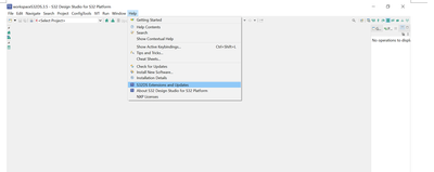

Would you please try using the flash tools under S32DS directory? before using it, make sure that you have installed the S32G development package for your S32DS, to check whether you have installed it, reference the following way:
If you do not have this package installed, just install it from the update part and try using the updated version under "C:\nxp\S32DS.3.x\S32DS\tools\S32FlashTool\bin".
