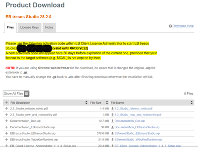

At your step2, once you are clicking through, you should be able to find the "activation code" to be used for your EB client license registration. here below a screenshot:

  My mean is that I can download the EB Tresos Studio and I had get the activation code,but when I fill it in the ''activation code'' window, it still reports an error message:
INFO: Trusted Storage initialization done.
Activating NodeLocked License 98B6-6782-A434-4E40, Number Of Licenses: 1
Status: 4, Creating request
Status: 5, Request created
Status: 6, Context created
Status: 0, Error
ERROR: flxActAppActivationSend (50041,41143,34)
Connection to FlexNet Operations Server failed.
