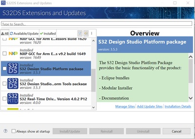

Hello, @MohamedAbdelslam
Thanks for your reply.
Once added, it could be found from the window:
Then you may try installing it, once installed, you may need to reset the S32DS to check the latest version.

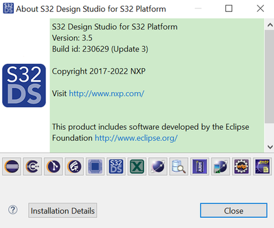

chenyin_h
I suggest using the S32DS 3.5.3, since it is compatible with most of the examples released.
Temporally I do not have 3.5.0 installed, but we tested it from another host with 3.5.14 and do not find such issue.
Would you mind testing it from 3.5.3?

MohamedAbdelslam
Hello, @chenyin_h
I've downloaded SW32_S32DS_3.5.3_D2306.zip, and it mentioned in the readme file that it is updatesite, so i added it in the s32ds extensions and updates but didn't appear to install it?
Could you provide how to install it?

MohamedAbdelslam
Hi @chenyin, thank you for reply
First I am using S32DS 3.5 not 3.5.3. when i click on Open Projects from File system and choose my project I find the project as a files not a project as shown in the attached screenshot as i cannot build project until i edit the settings of the project manually by myself (project nature in the setting and add c nature ) and other settings then i can build the project.
