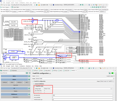

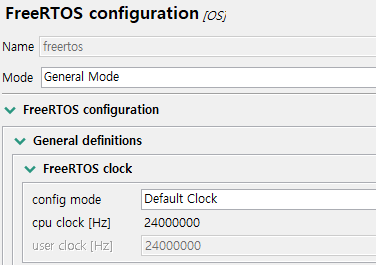

Hello and Happy new year!
I am developing sw for the S32G399A MCU (M7 core) using the S32 Design Studio tool.
My role is to develop the TCP/IP part so I created the example project (lwip_FreeRTOS_S32G399A_M7) and checked it.
After checking, I created a new project and following the contents of the example project.
But the cpu clock[Hz] in the FreeRTOS configuration didn't change even though I followed the exact same settings. (Pins / Clocks / Etc...)
And In the example, the config mode is Default Clock (not the User Clock)
I wannted to upload the screenshot buf unfortunately, due to my company policy, file/screenshot uploads are not allowed.
Could you please how to change the cpu clock?
Thank you.

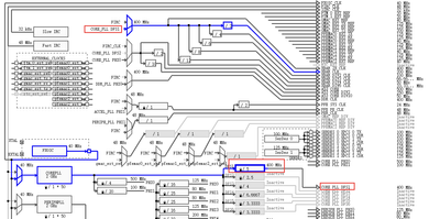

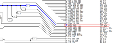

You need to fix XBAR_CLK as the following picture.
Joey_z_0-1736755555974.pngJoey_z_0-1736755555974.pngJoey_z_1-1736755565791.pngJoey_z_1-1736755565791.png
Hope it can help you.
Joey

Joey_z
hi,Boniface
In the FreeRTOS configuration, the CPU clock and XBAR_CLK should maintain the same value. To change the XBAR_CLK, you need to adjust CORE_PLL_DFS1 as shown in the following picture.
Joey

Boniface
Hi, Joey
Thanks for your fast reply.
I changed the setting but the clock didn't change.
Even though I clicked the Update Code button, deleted and re-added the freertos component in the Peripherals it didn't change.
What else should I check?
Boniface

Joey_z
hi,Boniface
Thank you for your reply.
I encountered the same problem when testing the provided .mex file.
However, I did not experience the issue when I set up a new project and added FreeRTOS as shown in the following picture. You can try setting up a new project only to add FreeRTOS; then, if the problem still occurs, you could try using version S32DS 3.5.3, which I normally use.
Joey

Boniface
Hi, Joey
My coworker installed S32DS 3.5.3 and created a new project.
He just added the freertos component after creating the project and the Default clock is still '0'.
(He didn't change the default setting, including clocks.)
Could you please check the mex file I attached?
Boniface

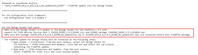

Joey_z
hi,Boniface
I have the same problem when I use your .mex file, but I did not encounter the problem when I created a new project to add FreeRTOS.I use the 4.0.2 HF3 version of RTD.
Refer to the Release Note, you can try the 4.0.2 version of RTD in S32DS.
Joey

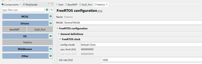

Boniface
Hi, Joey
Finally, I made it.
I installed S32DS 3.5.3 / FreeRTOS 4.0.3 CD3 / SW32G_RTD_4.4_4.0.2_HF02
and It worked.
Thank you for your help.
