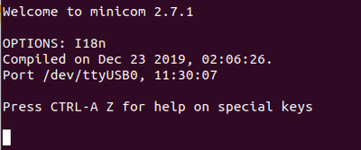

ashwini2024
The following is my local.conf file :
MACHINE ??= 's32g399ardb3'
DISTRO ?= 'fsl-auto'
PACKAGE_CLASSES ?= "package_deb"
IMAGE_FEATURES += "package-management"
EXTRA_IMAGE_FEATURES ?= "debug-tweaks"
USER_CLASSES ?= "buildstats"
PATCHRESOLVE = "noop"
BB_DISKMON_DIRS ??= "\
    STOPTASKS,${TMPDIR},1G,100K \
    STOPTASKS,${DL_DIR},1G,100K \
    STOPTASKS,${SSTATE_DIR},1G,100K \
    STOPTASKS,/tmp,100M,100K \
    HALT,${TMPDIR},100M,1K \
    HALT,${DL_DIR},100M,1K \
    HALT,${SSTATE_DIR},100M,1K \
    HALT,/tmp,10M,1K"
PACKAGECONFIG:append:pn-qemu-system-native = " sdl"
CONF_VERSION = "2"
BB_NUMBER_THREADS = "4"
PARALLEL_MAKE = "-j 4"
DL_DIR = "/yocto-s32g3/downloads"
SSTATE_DIR = "/yocto-s32g3/sstate-cache"
ACCEPT_FSL_EULA = ""
LICENSE_FLAGS_ACCEPTED:append = " commercial_elektrobit"
GCCVERSION = "11.%"
GCC_DISABLE_LANGUAGES = "fortran"
EXTRA_OECONF:append_pn-gcc = " --disable-languages=fortran"
EXTRA_OECONF:appen_pn-gcc-corss = " --disable-languages=fortran"
DISTRO_FEATURES:append = " virtualization "
DISTRO_FEATURES:append = " lxc"
PREFERRED_VERSION_linux-s32 = "6.6.12"
IMAGE_INSTALL += "modemmanager"
# Parallelism Options
BB_NUMBER_THREADS = "8"
PARALLEL_MAKE = "-j 8"
DISTRO_FEATURES:append = " hse "
NXP_FIRMWARE_LOCAL_DIR = "/yocto-s32g3/folder"
HSE_VERSION="0_2_22_0"
Inside my /folder/hse/bin the fw file is as follows:
rev1.0_s32g3xx_hse_fw_0.20.0_2.22.0_pb230821.bin.pink
 Now when i do bitbake ros-image-core and generate the .sdcard file and copy it and flash on the target machine and do sd card boot ,
i am not getting any logs and the output is as below displayed in the image.
Please let me know where i am doing an error .
THank you.

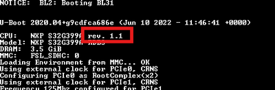

Celeste_Liu
In your environment, when executing the command "ls /yocto-s32g3/folder", the returned result is "HSE_FW_S32G2XX_0_2_22_0". Inside the path "/yocto-s32g3/folder/hse/bin", the firmware file is as follows: rev1.1_s32g3xx_hse_fw_0.20.0_2.22.0_pb230810.bin.pink.
For this purpose, please add a line "HSE_SOC_REV = "rev1.1"" in the local.conf file.
5,927 Views
ashwini2024
Why should i use rev 1.1 and not rev 1.0 ?
5,909 Views
Celeste_Liu
See the description in the document "Release Notes for S32G3 HSE Firmware 0.2.22.0".
5,905 Views
ashwini2024
Does that mean i can use any version or is it board dependent ?
5,883 Views
Celeste_Liu
It is board dependent. It can be seen from the startup print information of U-boot. On my side, the screenshot is as follows.
5,880 Views
ashwini2024
Whats the command to check that ?
5,875 Views
Celeste_Liu
No command is needed. It is the automatic print information when booting through the serial port. You can download any Linux BSP prebuilt image. After burning it to an SD card and starting it normally, you can see it. If you don't know how to download the prebuilt image, please tell me.
