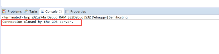

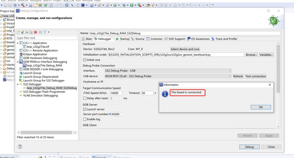

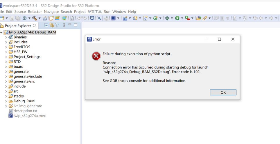

hi, NXP, when I use the S32 Debug Probe to debug S32G274, there is some problems.
check the picture bellow.
connection is ok.
Could you give us some advice on how to use the S32 Debug Probe?

Yi_Liu_Nxa22412
When you connect the S32 debug probe, please make sure:
1. PMIC set to debug mode, PMIC VR5510 won't issue reset to S32G. If the PMIC watchdog reset S32G during S32DS connecting to S32DS, it will report failure.
2. S32G at serial boot mode, the M7_0 core stay at serial boot mode.
