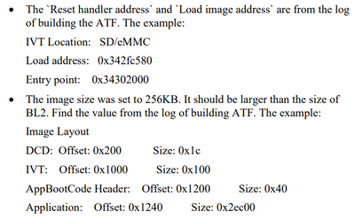

We were configuring our boot-loader to boot both the cores simultaneously. We are not able to find the reset handler address and the RAM entry point address of the BSP image which we built. Can you tell us where to find the address of mentioned above.
Thank you.

Which BSP version are you using? Commonly, this information is provided under the TF-A build process, similar to the one shown under AN13750 available under the S32G2 product page (link: S32G2 Safe and Secure Vehicle Network Processor | NXP Semiconductors) [Page 12, Enabling Multicore Application on S32G2 using S32G2 Platform Software Integration, Rev. 0, 11/2022]:
Please, let us know.
