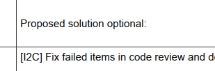

Then I started analyzing the release notes and noticed that many entries (bugs, new features, etc.) do not show the "Proposed solution" part completely in the document.
Example, ARTD-38632, Bug:
ARTD-71613, Bug:

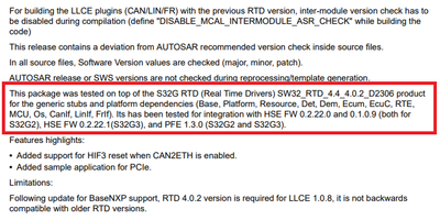

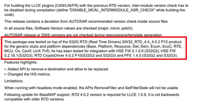

Unfortunately, there is not a LLCE version that has been tested with the RTD 5.0.0 yet.
I recommend waiting until a new LLCE version releases with test on the RTD 5.0.0 to port all your application to this RTD version.
I found the tested versions at the LLCE Release notes:
[page 2, Release Notes for LLCE 1.0.8, Rev. 1, 02/2024]
[page 2, Release Notes for LLCE 1.0.9, Rev. 1, 08/2024]
There is not a list of the non-RTD components at the RTD release notes because the non-RTD components firmware is done with the RTD as base, each non-RTD components mentions the RTD versions used to test develop/test it at each release notes.
Referring to the bugs you mention it are part of the change list, so that means that bugs are already fixed in the current version of RTD.
