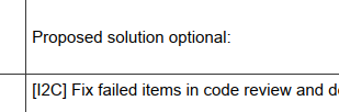

Then I started analyzing the release notes and noticed that many entries (bugs, new features, etc.) do not show the "Proposed solution" part completely in the document.
Example, ARTD-38632, Bug:
ARTD-71613, Bug:

Referring to the bugs you mention it are part of the change list, so that means that bugs are already fixed in the current version of RTD.
