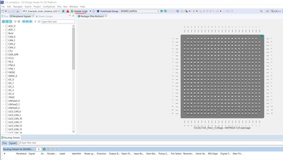

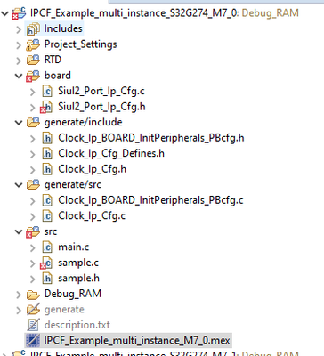

I'm working on a IPCF_Example_multi_instance_S32G274_M7_0. This example was not compiling, getting errors - header files are missing. My work is stuck because of these errors.
Can  plz help??

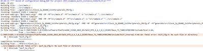

10:08:31 **** Build of configuration Debug_RAM for project IPCF_Example_multi_instance_S32G274_M7_0 ****

../src/sample.c:24:10: fatal error: ipcf_Ip_Cfg.h: No such file or directory
24 | #include "ipcf_Ip_Cfg.h"

../src/main.c:20:10: fatal error: Clock_Ip.h: No such file or directory
20 | #include "Clock_Ip.h"
compilation terminated.

To generate the code, you need to click on your project, then right click on it and select:
"S32 Configuration Tools > Open Pins"
Then, an "Update Code" is presented below the tool bar, with a green icon. Click on it to generate the code for the application. Image below shows the location of the button on our setup:
Once generated, you can try an compile the project, it should let you now. If not, we recommend deleting the project then importing it again, to prevent any misconfigurations that the project could have taken.

Hello, Daniel.

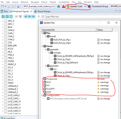

I meet the same problem as you mentioned above:
But I'm sure that I have performed to generate the code,
(There has some warnings and error, but not selected as default)
From the "c/c++ view" I could see these generated files:
Do you know why I still have this compile error even though I have generated the codes?
