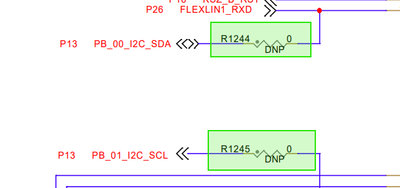

Sorry I did not notice the format of the paths before. but are you using a terminal that is not the windows command prompt? The steps are mean to be executed in windows command prompt.
Although I have not been able to run the RCON scripts. While investigating this issue with my colleague in the internal team, he has shared some important info:
  • The board needs to be an EVB, if you are using an RDB, you will need to modify some resistors. Please check the following part of the schematics:alejandro_e_0-1761678348775.pngalejandro_e_0-1761678348775.png
  • You need to close all instances of CCS.
Since you mentioned that you can already use the script, you may already know this, however I wanted to share it just in case.
Can you share the output of the command to ensure it is executing correctly?
8,791 Views
amerkle
Hi @alejandro_e ,
I mentioned in my first post that I am using the Mingw64 terminal provided by the S32 Design Studio. But the original problem is the same in a windows command line shell.
Thanks for the hint regarding the evaluation board, we are using the RDB3 and currrently a colleage is changing the resistors.
Find the output with the rcon script below, but consider that I used there the RDB3 without modification, thats why the I2C connection didn't work.

alejandro_e
Hello @amerkle
Sorry I missed the cygwin detail in the past. As you mentioned I see that now the process is being executed correctly, at least up to the point of the I2C, which should be solved when adding the 0Ohm resistors to close de I2C lines.
For now I am assuming everything works, however, if once you close the I2C lines you encounter any problem, please let me know so I can look into it.
