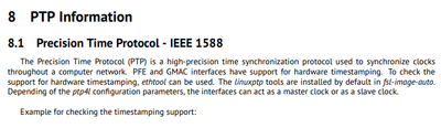

It seems the doc you shared is for using the PFE with PTP. But I want to use instead the GMAC which provide functions to offload the PTP messaging, controlled by GMAC_MAC_PTO_CONTROL register for instance.
Is there somewhere a high level API that I could use for that ?

You could use the PTP functionality with the linux BSP distributions to run it with GMAC
please refer to the Linux BSP 42.0 User Manual for S32G3 platforms (or the BSP Version you use) at chapter 8
Otherwise, you need to do your own implementation if you want to do it with the RTDs.
