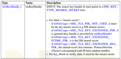

I am working on BSP 43 and I have enabled HSE I am using the HSE version : HSE_FW_S32G3XX_0_2_64_0. I am able to generate the pre-master successfully , I am trying to generate the master key by using the PRF function for TLS 1.2 , but its failing to generate it. I am following the HSE_API_REFERENCE_MANUAL , in order to generate the master key. Could you please let me know whether the inputs I am passing is valid.

You are usgin the following parameter as "not used", while the API manual indicates that for "master secret" is needed
Ensure the key handle (0x00020600) has the required flags
Please use a different key handle than pskKeyHandle, since they have different requirements
Please ensure that the targetKeyHandle (0x00000000) has the required flags
Please check the noes above and let me know if the behavior changes, if you receive a different error, please let me know.

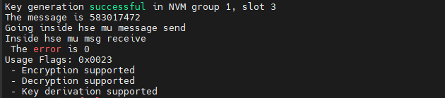

Also I have generated a AES-128 bit key in NVM slot and set the usage flag for the key handle as :HSE_KF_USAGE_DERIVE
Please let me know what is the issue with my service descriptor and why I am facing the general error.

Please share the output of the prints you have in your program and the key flags you have for the the three key slots you are using:
GET_KEY_HANDLE(HSE_KEY_CATALOG_ID_RAM, 6, 0)
GET_KEY_HANDLE(HSE_KEY_CATALOG_ID_NVM, 1, 3)
GET_KEY_HANDLE(HSE_KEY_CATALOG_ID_RAM, 7, 0)
Also please use memcpy instead of the assignment operator, as done in the demo app to avoid any problems:

I have attached the usage flags for the key handles.
