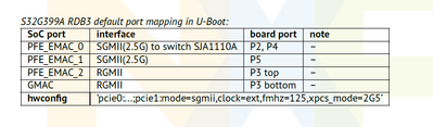

Hi Team,
Test Boards: RDB3, Custom board.
Software BSP: BSP34
BSP34 Linux BSP user manual was missing from NXP portal. Could you please share the same, as we are the reference command from BSP33.
One BSP33, PFE0 is configured to SGMII and we are able to ping the device.
The same SERDES1 configuration when tried with BSP34, at uboot the configuration is not taken and in Linux ping is not working.
Below are the command tried on BSP34 from u-boot.
command :
hwconfig=pcie0:mode=rc,clock=ext;pcie1:mode=sgmii,clock=ext,fmhz=125,xpcs_mode=2G5
In uboot it didnt showed the SERDES1 configuration and ping didnt worked on pfe0, even there is no error from pfe driver log.

Hello, @yellapu_anishkh
I was using the settings above for the test.
EMAC0 connected to Serdes1-lane0(could be used with P2, P4 by default mapping), EMAC1 connected to Serdes1-lane1(used with P5 by default)
When I tested for PFE0 in kernel/uboot, I used the P2 and P4, in total 3 ports involved, P5 is not related with PFE0, but PFE1.

Port4 is with a 100Base-Tx PHY and is connected to the SJA1110 network switch, while port5 is with a AQR113C PHY and is directly connected to the Serdes-1, the connection and PHY used are different for the two ports.
29,623 Views
yellapu_anishkh
Hi chenyin_h,
We are inline with the above understanding. But our focus is as per your log.
In the log you have shared you tested PFE_MAC0 with SGMII. port5 is with SGMII for PFE_MAC0 on SERDES Lane 1.
But the SERDES config used by you is for Lane 0 as below.
How this configuration is working for you.

From the BSP user manual, by default, the network ports mapping are shown above, PFE_EMAC1 mapped to the P5 port, not PFE_EMAC0, while the PFE_EMAC0 routed to the SJAxxx and could be used via P2 and P4.
I was using DIP Switches that default to the QSPI boot.

Thank you for the response. For your testing of PFE_MAC0, which port is used. port 4 ?
reason is if SGMII is used port 4 (for 2.5G) should be bigger similar to port 5.
29,654 Views

The test we have done are:
  1. PFE0, tested with P2A, P2B, P4 ports, which are all working correct(tested in both uboot and kernel).
  2. PFE1, tested with P5 port, the port pointed out from your attached picture, is working correct also.(Tested in the kernel)
  3. PFE2, tested with P3B port, is working correct.(Tested in the kernel)

We are looking for the same scenario as per your log. PFE0 SGMII, as per the table attached in image "2.png" there is no SGMII on P2A, P2B, P4 ports. Could you please confirm the port used for testing PFE0 SGMII.
Thank You,
