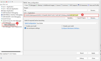

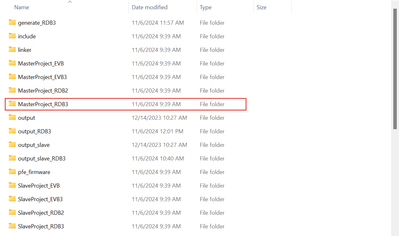

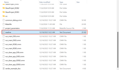

Joey_z
hi,GuilhermeS32G
To configure PFE-master for M7 core, you can refer to the PFE-DRV_S32G_M7_MCAL package MasterProject_RDB3 project. In the meantime, you can refer to the readme for more details to complete the setup. You can set IP_ADDRESS_CTRL_0 to set the IP address . RTD drivers must be installed, copy the installed RTD driver plugins and PFE driver plugin to Tresos plugins directory. Also, Run and debug the application with Lauterbach TRACE32.
Joey_z_0-1730879600804.pngJoey_z_0-1730879600804.pngJoey_z_1-1730879608076.pngJoey_z_1-1730879608076.png
Joey

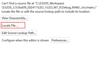

Joey_z
hi,GuilhermeS32G
It is recommended that you debug using Lauterbach Trace32 according to readme.txt requirements. The S32 Debug Probe can be debuggable by loading .elf files, but this is  unstable and does not ensure that you can debug successfully, you can see the following way.
If the following problems occur, try loading the main.c file.
Joey
