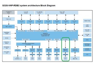

Where is the documentation of the PFE_MAC2 port registers? Base address? I am not finding register info.
I want to to get raw packets off of PFE_MAC2 where are the port registers? Base address? I am not finding register info. Eventually also PFE_MAC1. We are operating on base metal from A53 (not the M7) and are not using the PFE (packet forwarding engine driver).

Hello @aaronbaranoff,
Thanks for reaching out to us. Regarding your question, the base addresses of all the PFE_EMACs are:
EMAC0 - 0x460A0000
EMAC1  - 0x460A4000
EMAC2 - 0x460A8000
This base addresses share the same register as the GMAC interface, you can find all the registers in the GMAC subsystem reference manual.
You can also find some code references in:
pfeng/sw/pfe_platform/public/pfe_platform_cfg.h#L110
pfeng/sw/pfe_platform/hw/s32g/pfe_cbus.h#L23
Please let me know if you have more questions.
