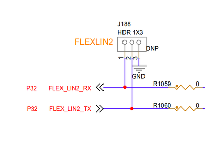

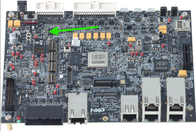

Thanks for contacting us again. Checking the TJA1124 documentation, you can see that it only supports Master mode. If required you could connect directly to the FLEX_LIN2 lines comming from the S32G2, you can solder a connector in J188 space (which is not populated) and connect an external board to it:
You can also remove R1059 and R1060 to only use the signal for the external board.
The connector is located here:

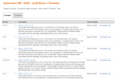

Regarding the LLCE-LinFlexD drivers, the design of the BSP is handle internally I cannot give you any details on why it is done a certain way since I don't have them. Regading the RTD LLCE examples, they do not come with the standard RTD package, you will need to enter FlexNet and follow this path: Automotive SW – S32G Standard Software > Automotive SW - S32G - LLCE Driver + Firmware, then select the version best suited for your project:
Please avoid using version 1.0.10 as some unrecoverable issues have been found. I would recommend version 1.0.9.
Once installing those packages in S32DS or EB Tresos, you will see examples for LLCE.
