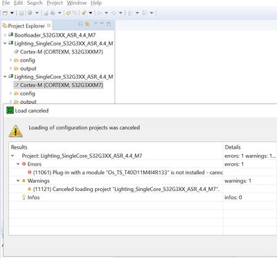

Hi ,
I am using S32g399 goldbox , we are trying explore one of the demo application(SRM_DemoApp_1.0.0_D2402), but we are not able to find one of the eb plugin here , i,e Os_TS_T40D11M4I4R133
same snapshot has been attached below and in document(SRM_DemoApp_1.0.0_D2402_UserGuideline) it say to use a particular os version
I am seeking here to get this particular plugin

Joey_z
hi,Karthik_7
Thank you for contacting us.
Could you download the package of S32XX_RTOS_4_4_133? The plugin of Os_TS_T40D11M4I4R133 should in the package.

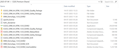

Karthik_7
Hello @Joey_z ,
Yes, we have the SRM package, but we are not able to find the particular plugin which EB package (SRM_DemoApp_1.0.0_D2402) is looking for (Os_TS_T40D11M4I4R133),
could you please try the same and let me know and below, I have attached our package please check anything we are missing here in the folder.
