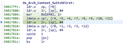

Hello, I got ccs: Bus error when debug S32G274 cortex m7.
Environment: S32G-VNP-RDB2, gcc compiler, S32DebugProbe & PLS UDE debugger.
Problem description:
Cpu fail when execute ldr.w lr, [sp], #4; with S32DebugProbe:
SP and LR before execution:
[sp]=[0x34063770] memory:

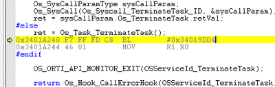

With the same elf file, load into PLS debugger, this instruction executes successfully, but it failed later when executed an branch instruction:

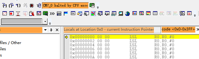

lost connection after execution:
The branch destination address is valid:
