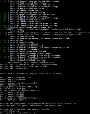

Hi everyone,
I worked on custom S32G274A SoC with Linux BSP33.0, it was working fine with PFE etc. Then i need to change my working environment so tried to get Yocto build project into new working environment. migrate.sh returns error and i saw that the link inside the migrate sh not valid anymore so i tried to get BSP35.0 and compiled it for my custom S32G274A SoC. it works but whenever i tried to enable PFE features with compatible PFE fw and driver, while booting kernel board resets itself.
As you can see in above snip it resets itself.
Does anyone work on PFE in Linux BSP35.0?

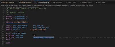

actually migrate sh is working but after getting repo and trying to run repo sync it says unreachable URLs for some source codes. i checked these URLs and they are really unavailable. I thought BSP33 migrate sh wont work any more. I just changed LPDDR4 RAM initialization code in TF-A source code and just disable PFE_MAC2 on U-Boot source code. There is no other changes on the code.

i disabled PFE_MAC2 in both BSP33.0 and BSP35.0 because our custom HW has different connection for pins which used by PFE_MAC2 than eval board. I could boot with BSP35.0 in eval board but in custom board as i said it could not boot. I just change 2 things in yocto project, one is for LPDDR4 2GB ram initialization code generated by S32DS DDR Tool in U-boot and AT-F, and the other one is just disabling PFE_MAC2 in U-boot s32g274ardb2.h file, updating a define which is PFENG_MODE changed from "enable, sgmii, none, rgmii" to "enable, sgmii, none, none" so that PFE is enabled and PFE_MAC0 is in sgmii mode and MAC1&2 are just disabled. I applied same changes on BSP33.0 and it works fine, i just wonder why i could not boot with BSP35.0 with same changes, which are just changing DDR ram init and disabling mac2 of pfe.

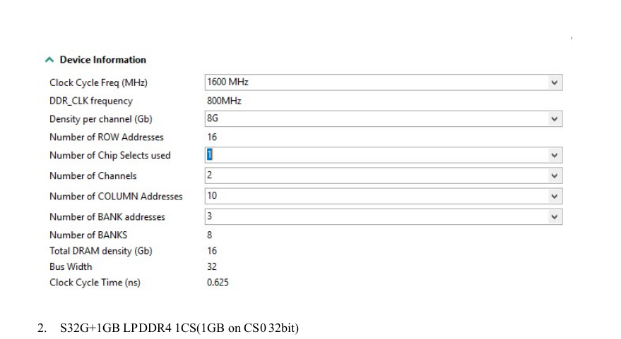

Please share the s32g274ardb2.h file and the DDR generate parameters here.

You can see changes in s32g274ardb2.h file as follows:
just update PFENG_MODE define.
and for 2GB LPDDR4 RAM, i used following parameter in S32DS DDR Tool and generate init code with that,

Did you follow BSP35 chapter 11 to integrate the DDR code into ATF?
The Instruction is different from BSP 33. Please look at this.
That could be the issue.
