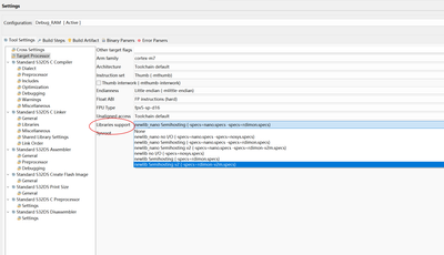

I am trying to use print trace to debugger console with the function of printf in S32G-VNP-RDB3 project. Noticed that "newlib Debugger Console" should be chosen for the item of  Libraries support in Target Processer page. But in my project, there is such a option with console. What else should be set?

Based on the following community post Semihosting printf with S32G274A - NXP Community
By now, "printf" using the S32 Debugger is an unsupported feature.
Therefore, we suggest you use a UART interface to implement a "printf" capability.
