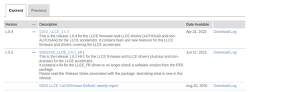

I am trying to enable LLCE on the fsl-image-auto target. I am using the S32G RDB2 (s32g274ardb2) running the AutoLinux BSP v30.
I extracted the firmware files to a local folder added the following two lines to my local.conf.
DISTRO_FEATURES_append = " llce-can "
NXP_FIRMWARE_LOCAL_DIR = "/third_party/nxp/llce/s32g2"
 Here are the files located in /third_party/nxp/llce/s32g2: dte.bin frpe.bin ppe_rx.bin ppe_tx.bin
These were extracted from the LLCE release 1.04
The image is able to be built fine, however, on boot, I get the following error messages. Do you know why the error is coming up? Am I missing any steps?
[    4.044114] llce_core 43ff8000.llce: TX boot failed with status: 0
[    4.044138] llce_core 43ff8000.llce: Firmware loading failed
[    4.044144] llce_core 43ff8000.llce: Failed to start LLCE cores
[    4.044267] llce_core: probe of 43ff8000.llce failed with error -5
I am aware the BSP guide states to use LLCE v1.0.2 however I cannot find that version for download on FlexEra. I see 1.04, 1.0.0 and 1.0.1. If the issue is the version, can you help provide access to LLCE v1.0.2?

Yep, I was able to solve on BSP v30 by using LLCE firmware 1.0.2. I was able to download it from Automotive Software Package Manager. Thanks!
