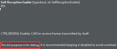

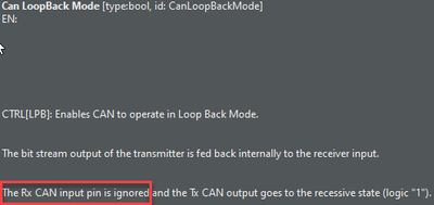

Query 3: Difference between loopback and self–receive.
The loopback mode ignores the RX pin from external messages (shown below) and self-receive is mainly for debug reasons (shown below).
DanielAguirre_0-1676918055031.pngDanielAguirre_0-1676918055031.pngDanielAguirre_1-1676918140997.pngDanielAguirre_1-1676918140997.png
Query4: Is there a possibility to only do self-receive and not loopback?
We do not see any restriction that requires both to be enabled at the same time, unless we are misunderstanding your query.
