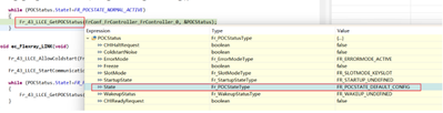

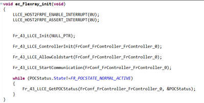

I want to implement LLCE Flexray function on S32G2. My versions are S32G_LLCE_1_0_6 and SW32G_RTD_4.4_S32CC_4.0.10. Add LLCE Flexray functionality to projects that already implement LLCE CAN and LLCE LIN functionality;

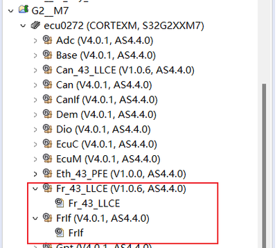

In EB configuration, the Fr_43_LLCE and FrIf modules and routines are the same.

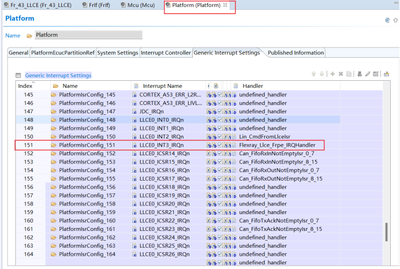

The LLCE0_INT3_IRQn interrupt is enabled on the interrupt module.

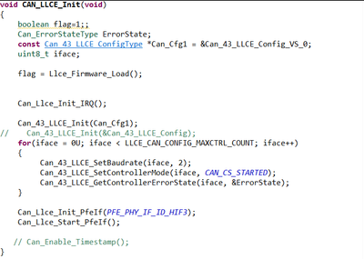

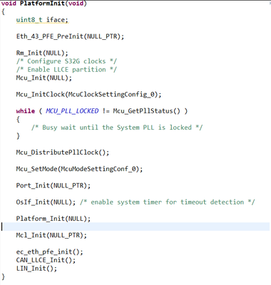

Call the LLCE Flexray routine after initializing the LLCE CAN, and LLCE LIN functions:

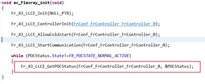

 In the while loop, the get state is always FR_POCSTATE_DEFAULT_CONFIG.
After debugging step by step, it is found that the Fr_43_LLCE_ControllerInit() function fails to write instructions, resulting in a timeout.
What is the cause? I can do something about it.

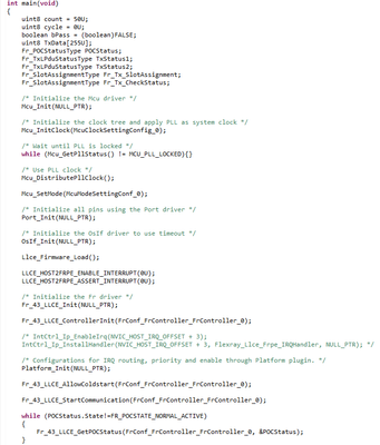

PXH1
hello,
We mask the other features and just run Flexray and LLCE v1.0.7 routines as shown. The following diagram shows all the functions we have running so far, but the phenomenon remains the same

Daniel-Aguirre
Thanks for your feedback.
We might be misunderstanding this last request. Were you able to use the LLCE v1.0.7 example? This since the code does not seem to be the one provided by NXP.
Given that LLCE v1.0.7 is the one that provides an example, we recommend using it to understand if the example works out-of-the-box. At the end, your application is a custom application and configurations might be missing, that is why we would like to use the same base example to understand the behavior.
As told before, we are unable to reproduce the outcome, we do apologize.

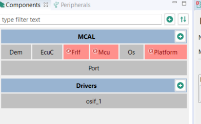

Do you have FlexRay LLCE example code for S32DS 3.5?
NXP  S32G_LLCE_1_09 package is not possible to configure components and compile it.
