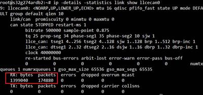

We want to use LLCE for CAN communication, but we have found packet loss,
Env.  BSP35  baud rate is 500K,
When there is no application software reading data in userspace, there is no packet loss when viewing the results through the <IP - details - statistics link show CANx>command
When an application reads data, the <IP details statistics link show CANx> command is used to view the results and it is found that there is a frame dorped.

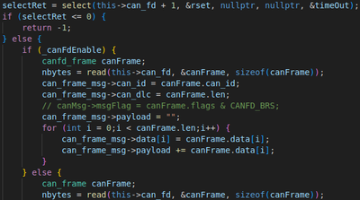

We implemented the userspace code in C++ and Python(socketcan lib) respectively, and the results were the same. The core processing of the C++code is as blow.
Could you pls tell us the reason and how to fix it,

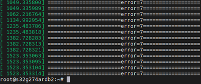

Following the method you provided,a lot  of error frames ware captured,the log and ip link message as blow:
BTW:
Additionally, regarding the issue of frame drop , we have added print to the LLCE driver,
It seems that the reason for the frame drop is due to LLCE_ERROR_MB_NOTAVAILABLE
StanleyShen_1-1695632446943.pngStanleyShen_1-1695632446943.pngStanleyShen_2-1695632454112.pngStanleyShen_2-1695632454112.png
Do you know the reason for LLCE_ERROR_MB_NOTAVAILABLE ?

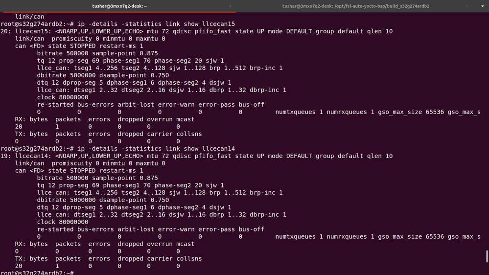

I go through your logs. I tried to regenerate in my pc with s32g274a-vnp-rdb2 board with bsp35, but i am not facing such type of error. i am sending 20 bytes as i described in my previous , i followed same steps
Screenshot from 2023-09-26 15-47-50.pngScreenshot from 2023-09-26 15-47-50.png
can you tell us which board you are using ?
are you using prebuilt bsp35 or you build with yocto ?
Regards ,
Tushar

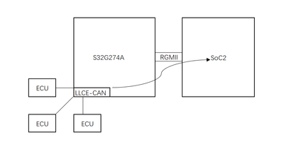

Maybe the CAN2CAN is not suitable for me, because I am using LLCECAN in the following scenario:
Is there any other way to solve the problem of CAN frame drop?
