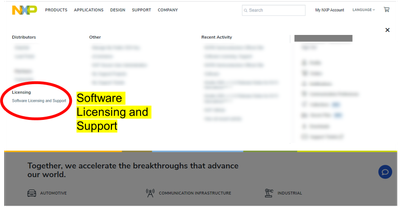

3,432 Views
masatakayakashi
Hi @abhinavdube ,
Please note the LinuxBSP28.0 is quite old version hence it requires very old LLCE FW (i.e. ver 0.9.1), which might be unreacheable by your account. Using recent BSP version is the simple way to play LLCE with Linux.
If your account has the access right for such old LLCE FW, you will reach it by the steps below on nxp.com.
masatakayakashi_1-1681105597049.pngmasatakayakashi_2-1681105630125.pngmasatakayakashi_3-1681105651968.png
masatakayakashi_4-1681105673772.pngmasatakayakashi_5-1681105729999.pngmasatakayakashi_6-1681105747664.pngmasatakayakashi_7-1681105762930.png
Hope this helps,
Masataka Yakashiro
