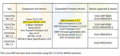

Env:
BSP38.0  pfe 1.5.0

1.5.0 Should be the Linux driver version, the FW should have a different version, can you confirm you are using firmware version 1.7.1? which is the version compatible with with BSP38 as per the release notes of that version.
One thing I can recommend is to use modprobe to remove and add the module, instead of rmmod; or find another mechanism of detecting the 5G module instead of loading and unloading the driver, this way, once the module is detected you can load the driver.
