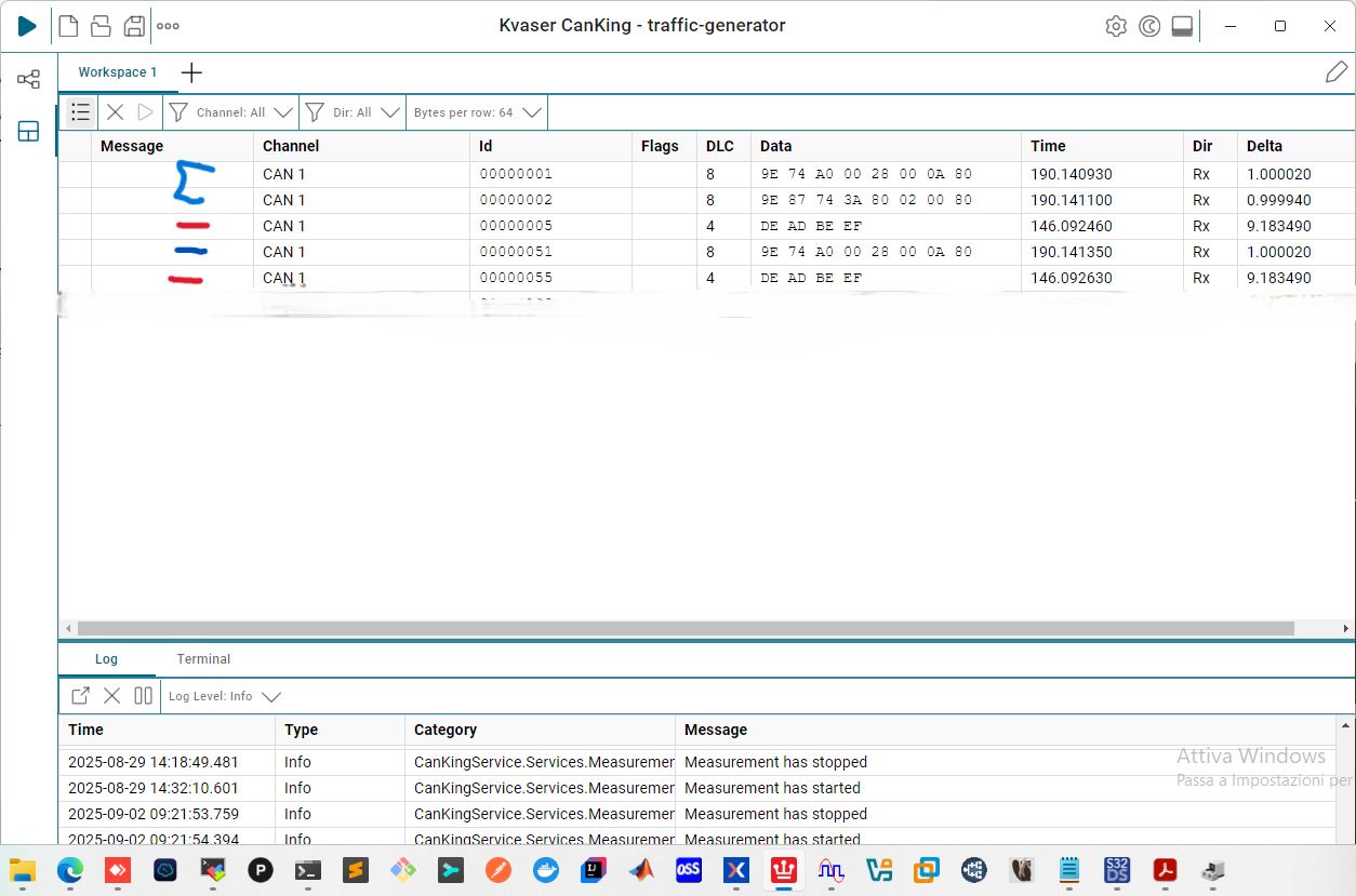

917 次查看
MrAlexIV
Hi Joey,
Thank you again for your reply.
Regarding to your comment:
1) Yes, I increased the interval. What I noticed is that it actually works even if the time interval is quite short, but only if the CAN messages are sent from two different devices. Let me explain better:
I’m using a CAN bus where I connect my external devices (which send CAN messages) and my LLCE line. Right now, I have two external devices connected. One sends two messages (0x01 and 0x02), and the other one sends a single message (0x05). If only the first device is active, I only forward 0x01 (as 0x51), while 0x02 gets ignored. But if I also connect the second device, which sends 0x05, then I can forward both 0x01 and 0x05 (as 0x51 and 0x55), even with a very short time interval. Why is that? Why doesn’t it forward 0x02 as well when both 0x01 and 0x02 come from the same device? Is it because they are sent by the same external device, or is it simply because the time interval is too short?
2) Yes, I’m using a CAN logger (Kvaser CANKing). I’ve attached a screenshot: in red you can see the message received from the second external device (0x05) and the one forwarded by the LLCE (0x55); in blue you can see the messages from the first external device (0x01 and 0x02) with the forwarded one from the LLCE (only 0x01, while 0x02 seems to be ignored).
3) Regarding the arbitration, what do you mean?
Thano you!
905 次查看
Joey_z
hi,MrAlexIV
Thank you for your reply and detail information.
It should be ok for your S32G CAN function for receiving CAN frame from two different device, could you try adding a time interval on a sending device? This should be useful for troubleshooting problems. It's likely that your second sending has affected the data return of the first one.
Joey
