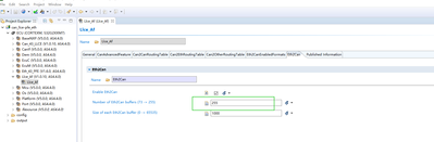

You can try to add the buffer ("Llce_Af > Eth2Can > Number of Eth2Can Buffer (72 -> 255)") in the configuration.

How to confirm whether Eth2can is running on a single core or multiple cores, and how to configure it for multi-core operation if needed.
LLCE version:   LLCE_1_0_10, and i have  use Eth2Can Buffer 255.

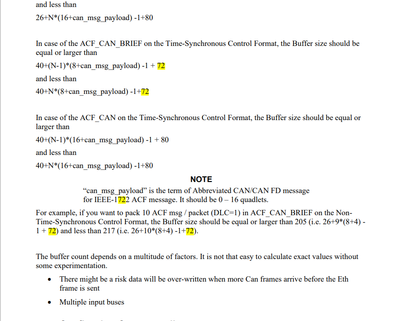

For multi-core usage cases, you can refer to AN13750.LLCE. For more specific usage methods, you can refer to AN13423 to obtain more information and have more detailed buffer setting suggestions.
https://www.nxp.com.cn/docs/en/application-note/AN13423.pdf
