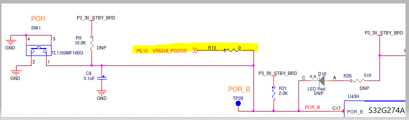

When debugging this issue, we knew the the POR_B pin on the S32G274A is input only. This is highlighted within the IOMUX spreadsheet attached to the S32G2 RM. Since this is input only, by looking at the POR_B test point on the RDB2 and seeing that it is being asserted whenever the POR in question occurs, we knew that the root cause was outside of the scope of the S32G274A. To further support this, the reset escalations described in the reset chapter (chapter 28) of the S32G2 RM shows that functional resets can be escalated to destructive resets, but not a POR. If a destructive reset was occurring, we would be able to see it through the MC_RGM DES register, but we did not see any indication of that. In addition, we also knew that the problem was not with u-boot since the functional reset is being correctly requested and if it was u-boot, the POR_B test point on the board would not be asserted.
Looking into the RDB2 schematic, there are ultimately two main sources connected to the POR_B line that could assert POR_B: (1) the VR5510 PMIC PGOOD line and (2) the POR button on the board. Since the button is not causing the issue, we started looking into the PMIC and studying its register values before and after the POR in question. It is through this that we found the overall cause.

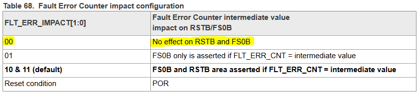

  2. Suggestion on how to achieve consistent functional resets without triggering POR while still enabling all other safety features?
    • For the fault error counter, you can use the FLT_ERR_IMPACT bits of the VR5510's FS_I_FSSM register that was mentioned above. Table 68 from the VR5510 Data Sheet details the different reactions that the VR5510 can take once the fault error counter reaches the intermediate value, as shown below. If you do not want the VR5510 to react to the fault error counter, setting these two bits to 00 will be the best option.
  • Please note that in setting the value of the FS_I_FSSM register, you will also have to set the FS_I_NOT_FSSM register with the 1's complement value of the FS_I_FSSM register.

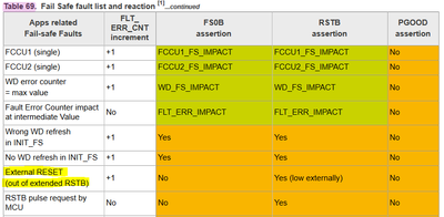

For the RDB2/GoldBox, the default One-Time Programming (OTP) for the VR5510 sets a fault error counter (section 22.7.1 of VR5510 RM) to have a threshold of 3 as part of its fault management features. This fault error counter's job is to count the number of faults that occur both internally to and externally from the VR5510. If the threshold is met, then it will implement the configured impact. In this case, the default configured impact is for the VR5510 to assert its FS0B and RSTB pins when the threshold is met.
Based upon table 69 of the VR5510 RM, external resets that occur and that are connected through the RSTB pin of the VR5510 are considered external faults and result in the increment of the fault counter, as shown below. In the RDB2/GoldBox schematic, the RSTB pin of the VR5510 is connected to the RESET_B line, which is also connected to the RESET pin of the S32G274A. When a functional reset occurs, the RESET_B line will go low and the VR5510's fault counter will be incremented.
When the second functional reset is performed by the S32G274A, the VR5510's fault counter will reach the value of 3 and the VR5510 will assert both its RSTB (RESET_B) and FS0B pins. Due to another default OTP configuration on the VR5510, the PMIC will also assert its PGOOD pin, which turns out to be connected to the POR_B line of the RDB2/GoldBox and causes the functional reset in question to become a POR. The assertion of the PGOOD pin on the VR5510 side is covered in the excerpt below from section 27.7.2 of the VR5510 RM.

  1. Why was default the configuration chosen to be this way?
    • In this case, the fault error counter on the VR5510 is configurable through a set of bits in the FS_I_FSSM register. These include:
      • FLT_ERR_CNT_LIMIT: dictates the max value and intermediate value for the fault error counter
      • FLT_ERR_IMPACT: dictates the reaction the VR5510 takes once the fault error counter's value reaches the configured intermediate value
    • Ultimately, the default value for the fault error counter is there only to have something as a default and to show how the fault error counter works. Since its operation is dictated by registers, the user can freely conform it to their desired behavior.
    • More information about the fault error counter and these configurations can be found in section 22.7.1 of the VR5510 data sheet
