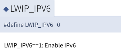

With the settings for enabling IPv6, then the stack would support both ipv4 and ipv6, if you do want to only use the ipv6, then undefine of the ipv4 would be required.
Besides, you may need to set a ipv6 address for the test, for example,

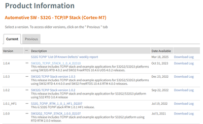

I am wondering the accurate version number of the S32G TCP/IP Stack, which version you are using from the following?
In general, by default, ipv6 is not supported, by setting the following to 1 would help to enable the ipv6

I am using the TCP/IP lwIP version - "SW32G_TCPIP_1_0_4_D2310_updatesite.zip"
I could see in code that i have option IPv6 enable and also i Have a option in TCP/IP middleware configuration ---> where i have ENABLE IPv6 option

1. Seems you are working with M core application? are you using the S32G - TCP/IP Stack? if yes, which version?
2. In general, the latest S32G - TCP/IP Stack released by NXP is based on Lwip2.1.x, as a result, the IPv6 could be supported, for the details guide for using/setting the stack, I suggest referencing the official document from https://www.nongnu.org/lwip/2_1_x/group__lwip__opts__ipv6.html
