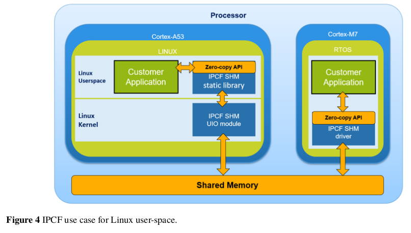

HI Team,
    I have a question about testing IPCF on board of S32g274.
  Test Model is Figure 4 IPCF use case for Linux user-space.
The source code and samples of IPCF implementation for Linux drivers are published on:
https://source.codeaurora.org/external/autobsps32/ipcf/ipc-shm-us/
The branch: release/bsp32.0
failed print:
When the test run generate_msg,it print "Bus error".
I test the model IPCF use case for Linux Kernel is OK.
Just modify the function generate_msg:
static void generate_msg(char *dest, int len, int msg_no)
static char *msg_pattern = " Test all test from kernel!\n";
snprintf(dest, len, "#%d %s\n", msg_no, msg_pattern);
sample_info("generate_msg is %s!\n",dest);
Do you have any suggest?

Daniel-Aguirre
Prior to understanding your application, what is the setup you are running? A53 with M7?
Before the modification, your application was running no problem?
Have you run the IPCF example provided (A53 with M7)? Did you have problems?
Please, let us know.

   I run  the IPCF example provided A53.
