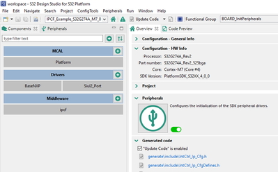

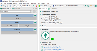

I successful installed S32DS on Windows and added RTD, LLCE and IPCF packages.
I created new project based on IPCF_Example_S32G274A_M7_0 project and run configuration tool.
I meet the following problems:
1st - the resource "platform.driver.pins" is absent:
The problem solved by clicking to icon:
and adding it to the project:
The 2nd problem is present in peripherals:
How I can to solve this problem?

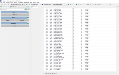

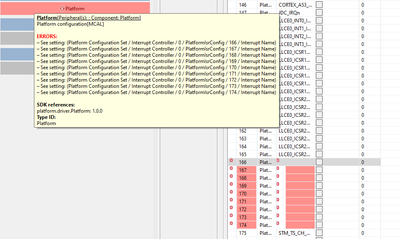

The peripherals view is:
You can see that 9 lines (from 167 to 174) have no values.
The values on each line can be selected from drop-down menu, but I do not know what should be selected for each line

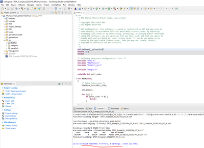

Still, below will be some captures on regards of the IPCF example you are using:
Before Updating the code
After Updating the code
DanielAguirre_1-1710178505295.pngDanielAguirre_1-1710178505295.png.
Platform Peripheral IRQ tab showing no errors
Successful compilation of the project
In summary, we understand that the steps were not followed to generate the code. If this still persists, can you help us understand which RTD/IPCF versions are you using?

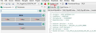

Daniel-Aguirre
Can you help us confirm which IPCF version are you using?
For the information you are providing, this behavior is expected by the NXP examples, since the requirement is to generate the code from Config Tools (which will add the required drivers). This is done by clicking the "Update Code" button. Once clicked and the code is generated, the errors should disappear. An example is shown below:
After updating the code
More information should be provided under the description.txt file available under the NXP examples.
Please, let us know.

The version of installed IPCF is:
I tried other IPCF examples (IPCF_FreeRTOS_S32G274A_M7_0 and IPCF_Example_multi_instance_S32G274A_M7_0) and the same problem detected - all these have missed information about the same pins 166-174 that have not interrupt name.
