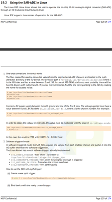

As for ADC itself, the available examples are provided under the BSP39.0 User Manual for S32G2 platforms [BSP39.0 User Manual for S32G2 platforms]:

Thanks for the update and the example, but this is from sysfs user space and not for a kernel driver.
I am looking for an example that utilizes the dts file and references to obtaining data within the kernel driver.
