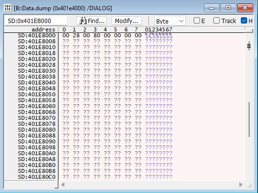

I2C_1:
I2C_1I2C_1

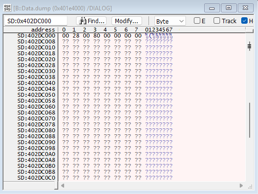

I2C_4:
I2C_4I2C_4

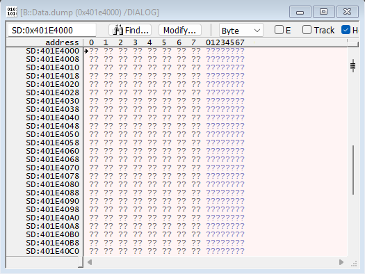

I2C_0:
Memory dump does not show any values.
I2C_0I2C_0
When we probed the SDA and SCL lines on the oscilloscope, no I2C activity was observed; both lines remained constantly high.

Thanks for the clarification, I understand now that you are doing SW partitions. Then I assume  you are using EcuC to create the partitions. If that is correct, please contact your software vendor, as for EcuC NXP does not provide any implementation, we only provide the stubs for the vendors to fill, my conclusion at the moment is that your QM partition does not have complete access to the memory sections needed for I2C_1. Also, checking the register values you shared, there seems to be no error in the module, in fact, it seems that the transfer was completed, I can see bit seven of  I2C Bus Status (IBSR) as 1.
