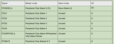

I connected two mcp2518fd chips on spi5 of s32g274rdb2, with CS0 functioning normally and CS1 failing to initialize. I checked the IO signal table and found that only PCS0 has two input and output modes, while other PCSs only have output modes. Do I have to use GPIO analog CS when using other chips?

There are 5 PCS signals supported on SPI5, so it is possible to connect more than 1 SPI devices.
Yes, only PCS0 supports IO
May I know exactly the current issues arise? only one spi device could work correctly?(PCS0), while the other one connected could not?(via PCS1)

Thank you for your reply.
I have already resolved the issue. It's because there's a hardware issue.
I tried using PCS and GPIO cs, and both were successful.
