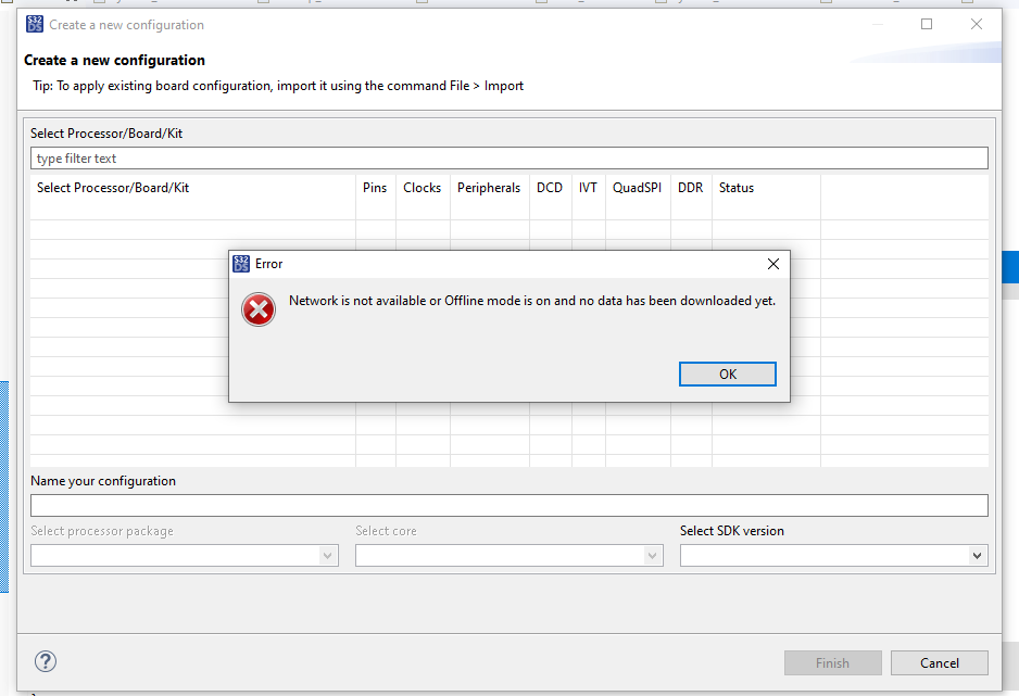

Fairly easy question here. I would like to program the cortex M7 of the s32g274a, but based on the read documentation some elements are not quite clear.
I have a regular USB-mini USB cable going from my laptop to the board, a test application I successfully compiled with S32 Design studio and the S32 Flash tool. I have tried uploading my .elf file as-is using the s32 flash tool but got the following error: "Program finished with error # -1073741819"
presume I get this error because the board is not in serial boot mode, based on some info I found online this seems to be a prerequisite. There also seems to be a second prerequisite which is that the .elf file needs to be converted to a "blob". I tried doing this, but this failed as well:
Yet the IDE was installed in online mode and my internet connection is stable. So it is not clear what the issue is here either.
2 Questions:
  • How does one put this board in serial boot mode? (couldn't find useful info in the datasheet)
  • Is it mandatory to convert the .elf file to a so-called blob? If yes, how can the error the IDE is showing be solved?
Refer to your board documentation. On NXP reference or evaluation boards the appropriate boot time configuration signals are routed to switches that allow to select the boot mode.
If you want the processor to boot directly into your application, yes, you have to create a bootable binary in the format recognized by the boot ROM. ELF is not valid for that.  Refer to S32DS User Guide, section titled "Debugging with S32 Debug Probe from flash for all other targets" for the recommended steps. As of the error you are observing, it is most likely because not all extension plugins required to work with S32G2 are installed on your machine. Familiarize yourself with this document. It explains what to install  and how to make a compact workable example for NXP S32G-VNP-RDB2 in maximum possible details.
