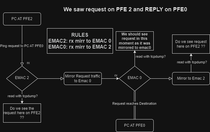

my goal is to investigate incoming networktraffic going through the Ethernet ports of the S32G-RDB2 board, on the host linux BSP running on it (For now all traffic -> Not using/benefitting from offloading). Using tcpdump on the host to listen to pfe0, for example, does not show the traffic exchanged between two devices connected through pfe0. Therefore I wanted to solve this by mirroring traffic by using the PFE mirroring functionality, after failing with theSJA1110 mirroring functionality. Unfortunately I also had some problems in configureing the PFE driver correctly:

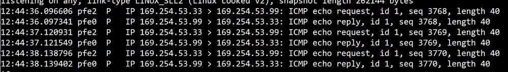

I tried using the mirror-add functionality of the PFE libfci_cli library pre-installed with the linux 36.0 BSP. I only found one case, how to read ping traffic between 2 devices connected through the board. I connected one device on PFE2 and another device on PFE0. Now I created the Mirror rule “MirrTo2”, which mirrors to emac2, and “MirrTo0”, which mirrors to emac0. I added the rules to the rxmirr0 variables of the physical interfaces. emac0 - rxmirr0: MirrTo2 and emac1 - rxmirr0: MirrTo0. This way both devices could communicate with each other, and I could read the ping traffic (PFE2 pings to PFE0) of the devices as shown in the following picture. I also activated Promiscuous mode on both emacs for simplicity. First.PNG
Connecting both devices to the PFE0 and using the rule emac0 - rxmirr: MirrTo2 does not show any traffic of the devices unfortunately when listening with tcpdump on the host. Why is this the case? I can also not follow why I can see the Ping request on PFE2 and the Ping reply on PFE0 in our first experiment. I tried to summarize my thoughts about this on the second attached picture. Additionally, it is not clear to me why I can see the traffic of the devices in first place, as other mirroring does not show the traffic to the host. Can you give an explanation?
