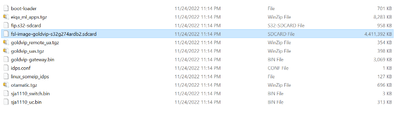

Hello, I´m currently working with the Image GOLDVIP for the goldbox development board, I´m using version GOLDVIP S32G2 1.7,
I already opened and modified the goldvip-gateway project on EB tresos and I compiled the project using S32 Design studio, all this following the "S32G Vehicle Integration Platform (GoldVIP) User Manual GoldVIP for S32G2 1.7.0" and I have the file goldvip-gateway.bin..
My question is the next, after this steps that I mentioned what are the next steps to flash that goldvip-gateway.bin file into the goldbox, I already read the Bootloader part of the user manual but I don´t fully understand what I need to do to flash that new .bin file to the goldbox and see those changes (for example I did changes on CAN gateways..)?
the Goldvip image that is currently loaded on the goldbox was loaded with the .sdcard image that is provided when I downloaded the binaries of the Goldvip image...
Thanks for your help!

Hi @eliozepeda,
Thank you for reaching out to us.
Please follow the steps below after the compilation of goldvip-gateway.bin
1. replace the "goldvip-gateway.bin" in GoldVIP1.2.0 SD Card(pre-build image). It would be in the boot partition
2. run "run write_gateway_app" in uboot command prompt, program "goldvip-gateway.bin" to NOR-Flash then reset by following the step in "S32G Vehicle Integration Platform(GoldVIP) User Manual"
3. boot to Linux, run the test command as the picture below, here we have "Rx frame" always "0", which means no frame routed from LLCE CAN0 to LLCE CAN2.(following the step in "S32G Vehicle Integration Platform(GoldVIP) User Manual")
Please find the attached image for your reference.
Hope this helps you.

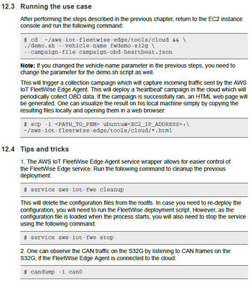

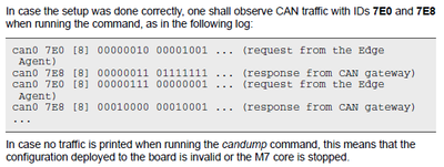

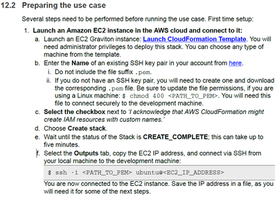

I´m having problems with the demo aplication of the GoldVIP image, I followed the steps in the S32G Vehicle Integration Platform (GoldVIP) User Manual chapter 12.2 and 12.3.
When I run the candumo can0 command I can see that the edge agent is requesting data as shon in the image bellow:
but there is not answer from part of the core M7 application, in the user manual says that it could be because the core M7 stopped but how do I run it again?
also in one of the firs tests I made the core M7 answer correctly but then stopped responding

Hello @MayanksPatel I´m running the goldvip-gateway application, in that application is configurated some gateways and also is configured the DCM and DEM that are running on M7 to answer to the Edge agent requests of services like 01, 03, 09 as described in chapter 12.0, but this application is not answering to the requests, it seems it is stopped

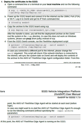

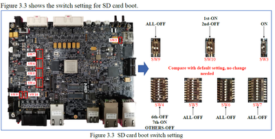

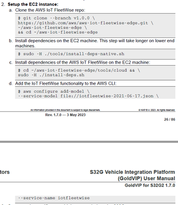

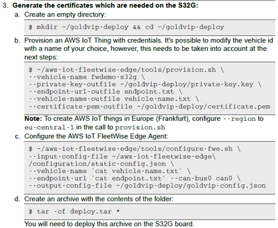

Thanks @MayanksPatel! the steps I followed are described bellow:
1.- I download the image GOLDVIP 1.7.0
2.- I flashed the .sdcard image into an SD card
3.- Once the sd card is flashed I inserted it to the Goldbox and I configured the switches with the SD card boot setting
stop in u-boot console when prompted, and run the following command, which writes all the images in flash.
After all the binaries are written, power off the board, configure the DIP switches for NOR
Flash Boot mode (set SW4.7 to OFF) and then power on the board or reset the board.
Then I followed the steps documented in the user manual to install the Fleetwise edge agent to the goldbox:
As I mentioned the edge agent is doing the request correctly with the CAN ID 7E0, but the M7 is not responding nothing, it should response something like the image above.
Thanks!
